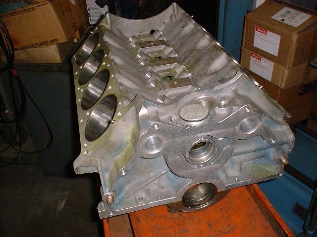

Message  Invité le Ven 01 Juin 2012, 14:03
Salut copoz!
481708 est le vrai # de block pour RA V Twisted Evil
Le voici ton block en aluminium:
From these production numbers; if we assume there are no gaps, there are at least 157 1970 crate RAV motors.
Blocks stamped DS-1941A have RAV characteristics and I believe are the pre production blocks.
There is an aluminum block cast DS-1001 that has RAV characteristics
http://books.google.ca/books?id=eT7LT69STO0C&pg=PA114&lpg=PA114&dq=pontiac+ram+air+engine&source=bl&ots=4DvloyTM4e&sig=QPSFU5kxkPC-xZGNl4Gj3S3m00g&hl=fr&sa=X&ei=R_jIT6nwHq716AGs5O0p&ved=0CFoQ6AEwBzgo#v=onepage&q=pontiac%20ram%20air%20engine&f=false
http://www.428gto.com/rav.htm

Salut Domtruck
Belle trouvaille thumleft
la on commence a y voir plus clair thumleft
il est certain qu'on ne voit pas ce genre de moteur a tout les jours
mais sa ne veut pas dire que sa n'existait pas pour autant

Message  427copoz le Ven 01 Juin 2012, 22:07
D'autre informations en provenance d'ici thumleft
About 10 blocks made it out of the factory before the program ended. According to Alex Hiller, a former Pontiac prototype technician, approximately 100 of these blocks were cast at the factory, though most were scrapped due to cracking of bores and mains during testing. Head sealing was also a problem, particularly with the larger bore sizes. A racing boat engine he built using the same block came apart in a similar fashion. Former Pontiac Special Projects Engineer Tom Nell confirmed that 10 blocks made their way to Sevakis before Special Projects was closed down. He lost track of them after that and ended up leaving Pontiac altogether, opening a successful bike shop in the suburban Detroit area.
It doesn't appear that Sevakis actually delivered more than one or two finished blocks to customers, as at least six unmachined units have popped up over the years. A fully-prepped block was pictured in an Aug. '72 Car Craft article, however.
Greg managed to hunt down one of those unmachined blocks (casting date January 7, 1972) and purchased it from Pontiac Heaven's Steve Barcak. It was in exactly the same shape as when it was popped out of the mold, so it was sent to Kauffman Racing Equipment, who fully machined the block, which was then treated to a special salt bath to preserve the aluminum. The bores were sleeved to a final bore size of 4.155 inches. The sleeves actually correct the majority of the cracking problems originally experienced during testing, as the cracks generally originated in the bore area and quickly spread.
source:highperformance Pontiac
Read more: http://www.highperformancepontiac.com/features/hppp_1001_1970_pontiac_trans_am/viewall.html#ixzz1wb43jiT2
DS 1001 casting number identifies it as a late prototype piece-a factory casting number would then be assigned to the production version, which in this case, never came
Re: muscle car
Message  427copoz le Dim 03 Juin 2012, 08:30
Je ne comprend pas tout de ce qui est écrit dans tout ces texte en anglais
il y a t'el deux moteur RA V aluminium 70 différent dans l'histoire
celui qui est dans la Trans AM 1970 1/2 et celui que le gars montre dans ces bras
et qui pèse 94 livres
un des block aurait un casting date 1972
de Greg managed to hunt down one of those unmachined blocks (casting date January 7, 1972) and purchased it from Pontiac Heaven's Steve Barcak
Read more: http://www.highperformancepontiac.com/features/hppp_1001_1970_pontiac_trans_am/viewall.html#ixzz1wjUIH0qh
Re: muscle car
Message  Invité le Dim 03 Juin 2012, 08:43
Ça a l'air d'avoir été un projet qui a avorté car il aurait coûté trop cher pour l'époque...
With a price tag of $2,000 for a complete block with main caps back in '72-'73, they were far too expensive to be commercially viable. That was a serious chunk of change back then, about $10,000 in today's money, according to the Consumer Price Index inflation calendar.
C'est ici que ça a chié Laughing
Re: muscle car
Message  427copoz le Dim 03 Juin 2012, 09:08
Domtruck a écrit:Ça a l'air d'avoir été un projet qui a avorté car il aurait coûté trop cher pour l'époque...
Salut Domtruck
A tu vu une place ou il disent que cette Trans AM est sortie de compagnie avec ce moteur 488 RA V all aluminium
ils disent quel est PHS documenté ,sauf que sa dit quoi exactement
Re: muscle car
Message  Invité le Dim 03 Juin 2012, 09:39
Non!
D'après ce que je lis:
When it came time to find a car for this unique powerplant, the decision to move away from the GTO Judges he was so familiar with was bolstered by the handling advantage that having 100 pounds less on the nose would bring to a Trans Am. After searching for an early Second-Generation Firebird, he happened on this 68,000-mile original example in December 2008 on, you guessed it, eBay. It was in very good original condition, but the factory-installed engine was long-gone, making it a perfect recipient for this exotic piece of Pontiac history.
C'est la continuité d'un projet avorté chez Pontiac, il aurait sûrement voulue mettre son moteur dans un GTO mais...
Re: muscle car
Message  buicker le Dim 03 Juin 2012, 20:15
Dans cet article ça dit que cette trans am 70½ a un moteur fait en 1972 que le gars a acheté sur ebay.
